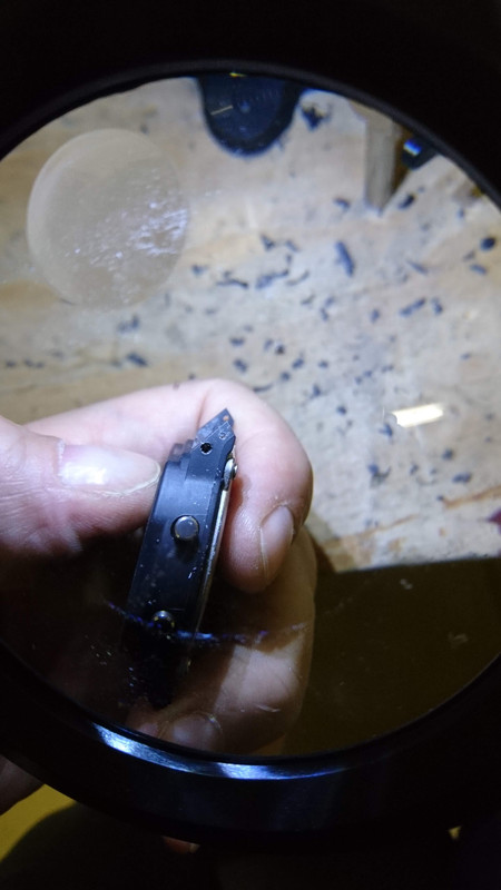

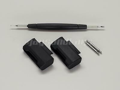

Now it’s time to build it with 20mm nato straps and fixed lugs.I read online that the producer had a special guide to drill the lugs and a special tool or shape to make the process of drilling and milling the case of the watch automated and easy to do.
https://i.postimg.cc/MT1T4mr8/DSC-0019.jpg

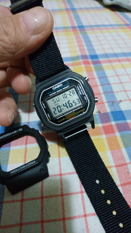

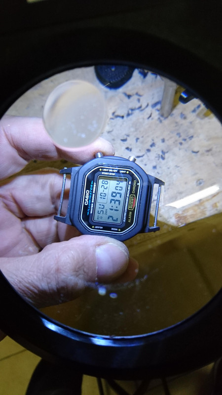

Sooo… after damaging a DW-5600E that i had in my drawer … i found a used DW-5600E case .At this point i choose to build a stamp using the old watch in order to get the holes that i would have to drill into it in the desired position and in a straight and simmetrical place…

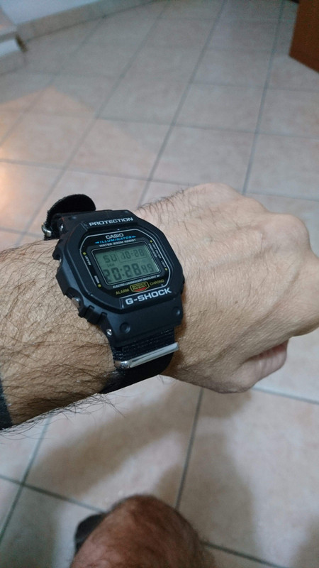

A friend of mine helped me into building the special mold with reference holes in it … and then i used it to drill the holes … later i completed the process of trimming the case using a dremel and others tool and in the end i think i built a Mil-Shock very close to the original… objouvsly this one isn’t one built by countycomm… but hey… i did it because there’s no luck to find one of the original online for sale … so i give it a try …
Now there’s some pictures to clarify how i did it.
